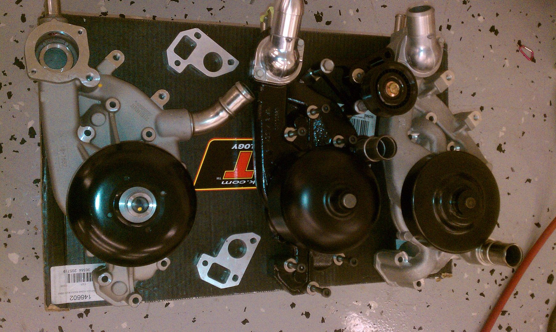

Look for RICHIRAM he put a car style on his but it was a stock LS3 intake and he was able to use his 07 pump. With the FAST I really dont know for sure if the 07 pump will work. You also can use an L99 water pump it has the right spacing to work without the spacers the LS1 needs. The L99 will move your upper radiator hose to the other side of the wp pulley. Here is what I did to make the car style 102 fit.
Cut stock bracket. I used a variety of air cut off and grinding tools and it turned out pretty good. If you get another bracket to cut look at the casting number there are different PS pumps.
Alvin at PCM 4 Less sells the idler pulley relocation kit. It has a longer bolt, speacer, and washers if you need.
Water pump. If you use an LS1 pump you will need .75 spacers to make it line up with the other pulleys. The L99 fits without spacers but the upper hose is in a funky spot.
Keep in mind you will need an new fuel rail, and somewhere to mount the EVAP solenoid which normally attaches to the truck rail. Also the vaccum hoses on the intake will have to be dealt with as well.

Its A LOT more work and money to make the car style fit. I believe the manifols alone are about the same price. For the car style you have to buy a different water pump, spacers, idler kit, fuel rails, vaccum hoses, and some custom work. The truck just needs massaged a little to make it fit. Then you can use pretty much all your stock stuff to finish it off.
Here are the three pumps I have. L99, LS1, and TBSS.
Another pic of what I cut.
You will need a new tensioner too.
