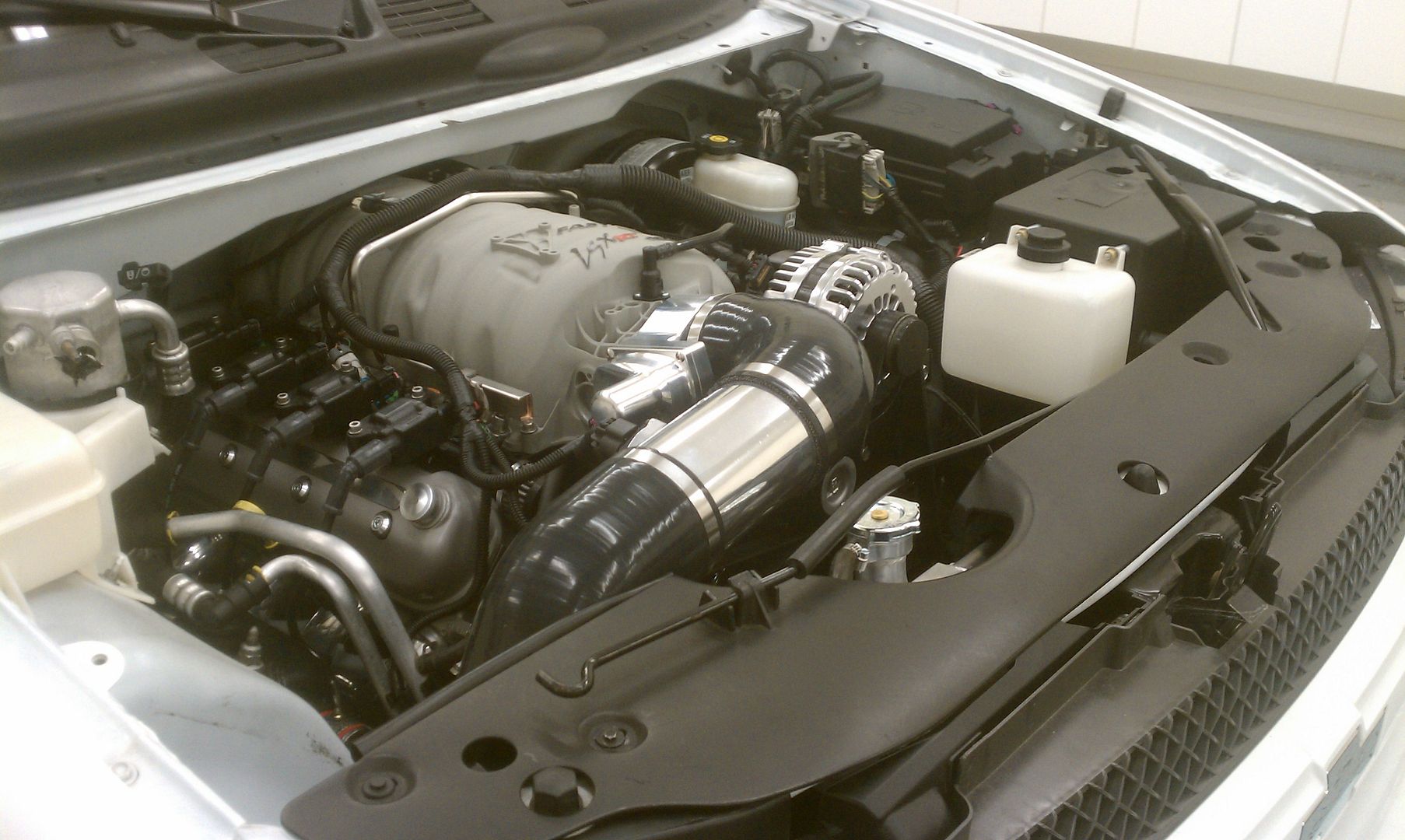

Does anyone have pictures of there fast intake intalled? What holes do I need to open on this thin to make it work? Pressure sensor port?

So from what it looks like I only have to punch out two holes right? The one in the back and the small front fuel return line correct?

N/m it looks like the two hole I have to punch out are on top right? That why I needed the maf extention right?

Thats right,you will need to drill the top map sensor bung and the evap port.

It crazy how much oil residue was under the stock intake! I will definatly be geting a catch can after this install.

Do I need to put some washers or somthing for the square fuel rail kit to sit properly? I'm using stock injectors for now. And I pushed the rail with the injectors as far a it will go and the hold down wont sit all the way down.

I had to put 4 washers under each bolt to get it to set right.

Here is mine
Not running stock injectors but I had to use a kit from from FAST to hole the rails.

Originally Posted by JCattSS View Post
Here is mine
I like what you did with the coil packs...

Are those Katech valve covers and coil relocation brackets???

Yes katech. They are supposed to be machine silver but match up with the FAST pretty well. I got some machine silver paint for the intake but its not very close.
